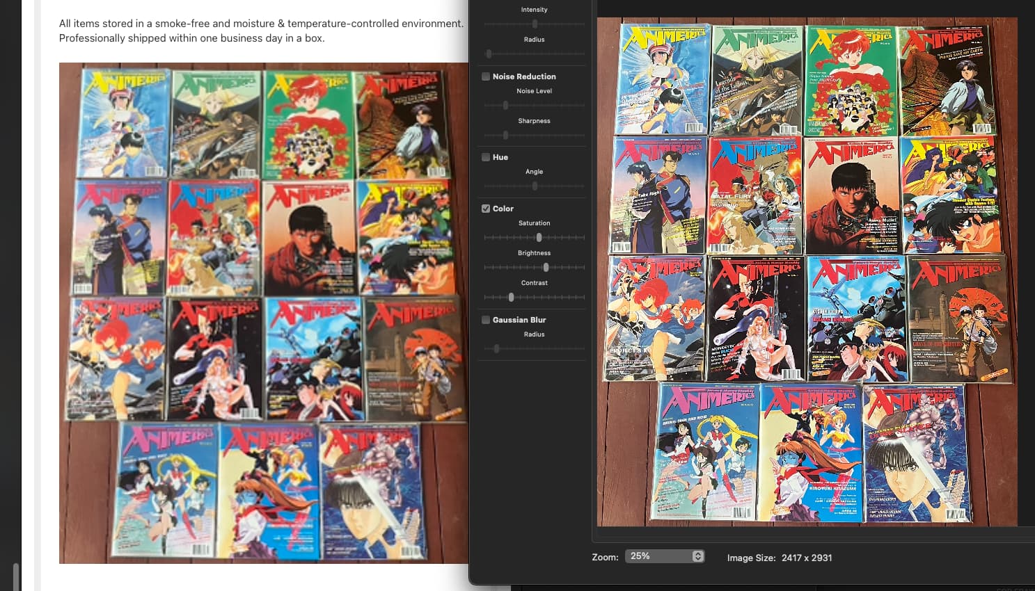

When in Editor Mode, and after dragging photos to the Drop Zone, the images show up as blurry. Double clicking them to open the photo editor shows the images as sharp. Is there any way to fix this? See screenshots below. Thanks.

Interesting. I wonder why it looks good when you add it on your copy of GS. I am using a theme - Pro Package. Making the GS window size larger will change the look of the page a bit, but keeps the image quality quite blurry. I use GS next to another app so I don’t have it set to be full screen. When using the Live view [this listing has been posted], the size of the image is the same, but it is tack sharp.

Another example that is really, really bad. GS editor on the right with the image about the same size as the GS preview window but WAY sharper than the preview/edit window of GS. macOS 14.7.4 - any help with this at all?? :frowning:
