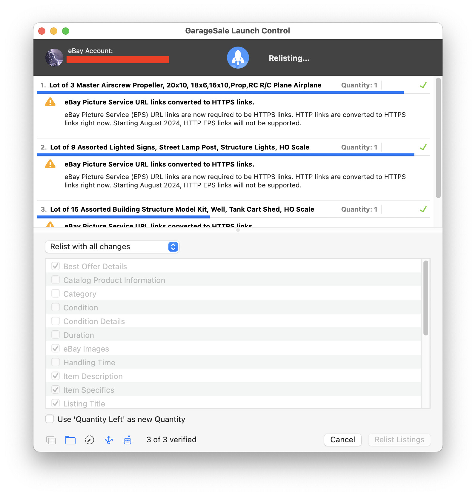

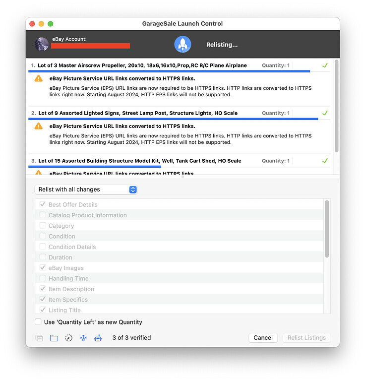

The warning that occasionally popped up a few weeks ago has returned with a vengeance as we get closer to its deadline. It’s showing for all my listings, now.
Today, all new uploads mention it. Again, it’s a warning not an error, but it does feel as if some fundamental change has been building up. The question is, is it something in the templates we’re using? What exactly happens when we use a GS template that refers to EPS? I honestly just use one off the shelf, and have never examined its source code very closely.

Yes! This warning came back yesterday for ALL of my listings…

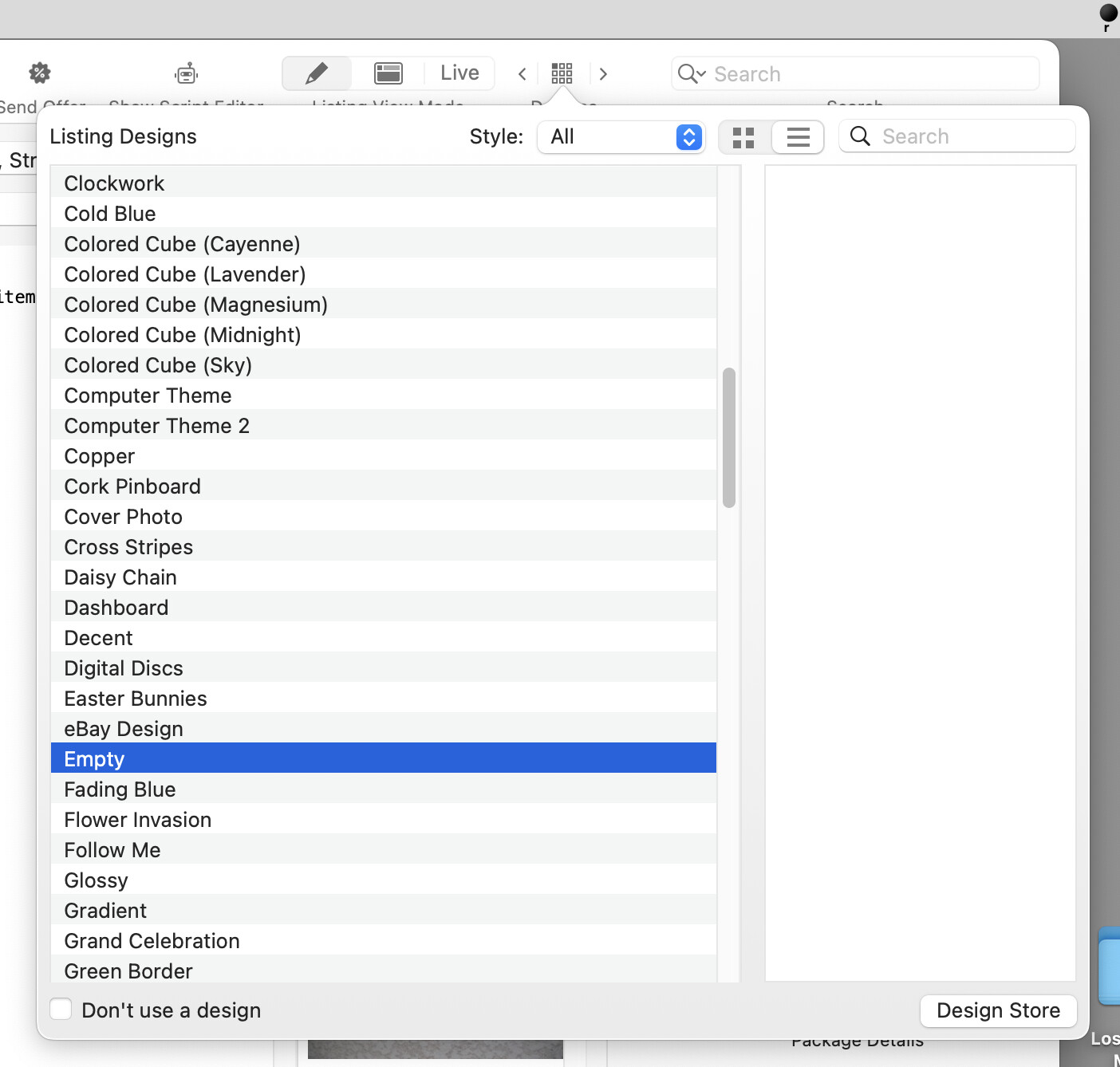

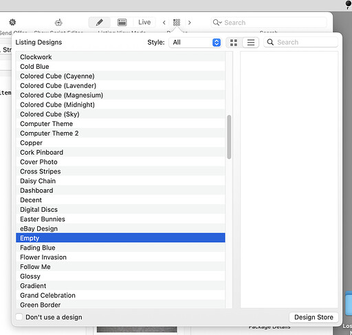

I use the “Empty” Design for ALL my listings.

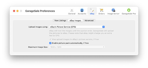

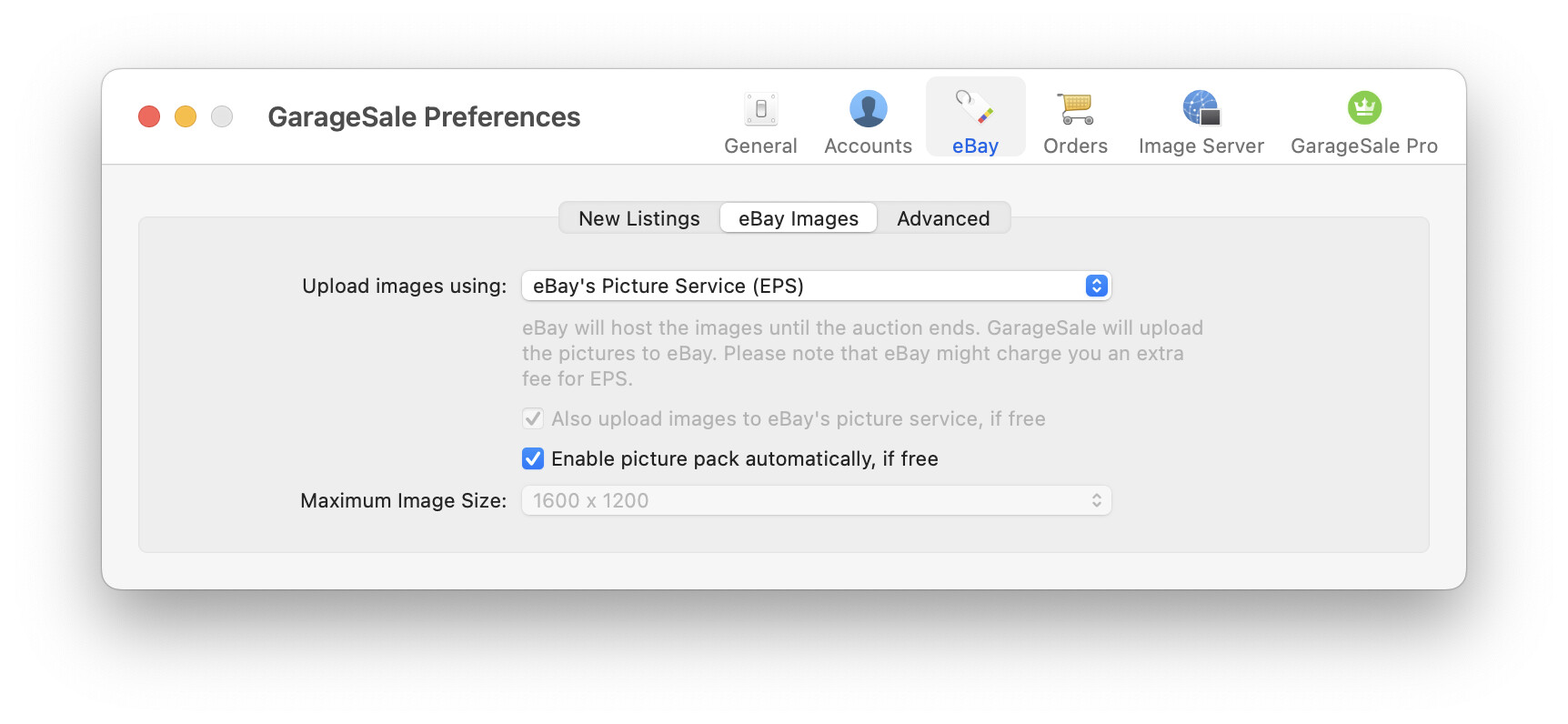

MAYBE the EPS upload uses http, instead of https???

Both, Starting and Relisting give the same new warning, on ALL my listings.
It must be in the verifying/uploading photos to EPS???

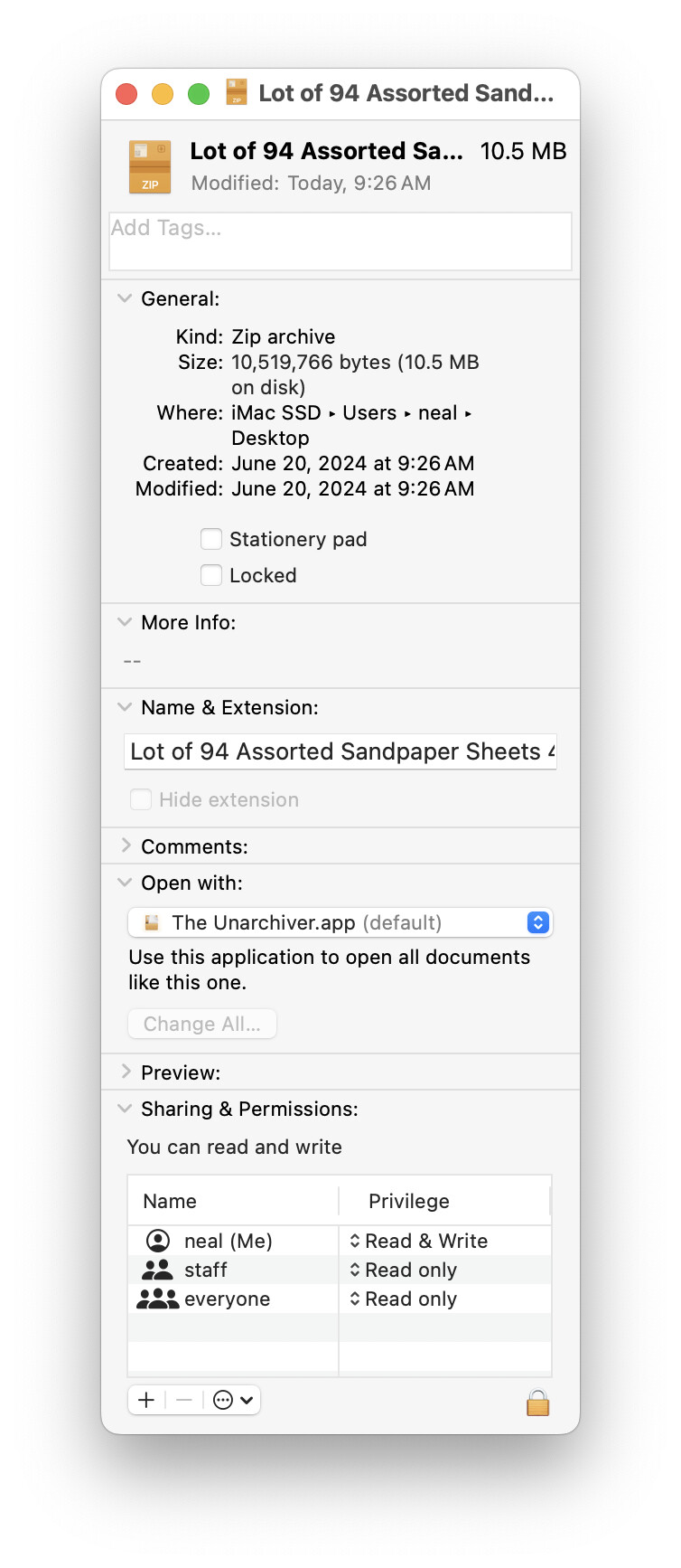

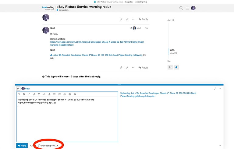

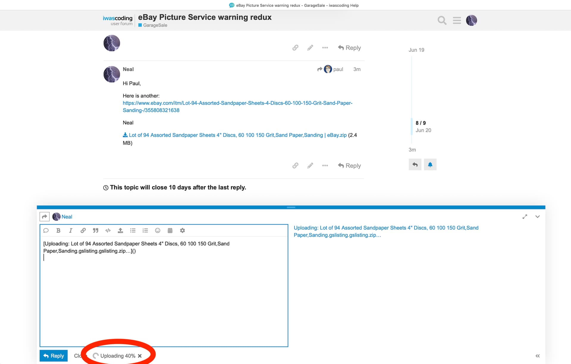

I tried to upload the compressed .gslisting file, but it kept getting stuck (after several minutes) on “Uploading 40%”…
See 2nd photo below. Maybe upload file size is too big???
