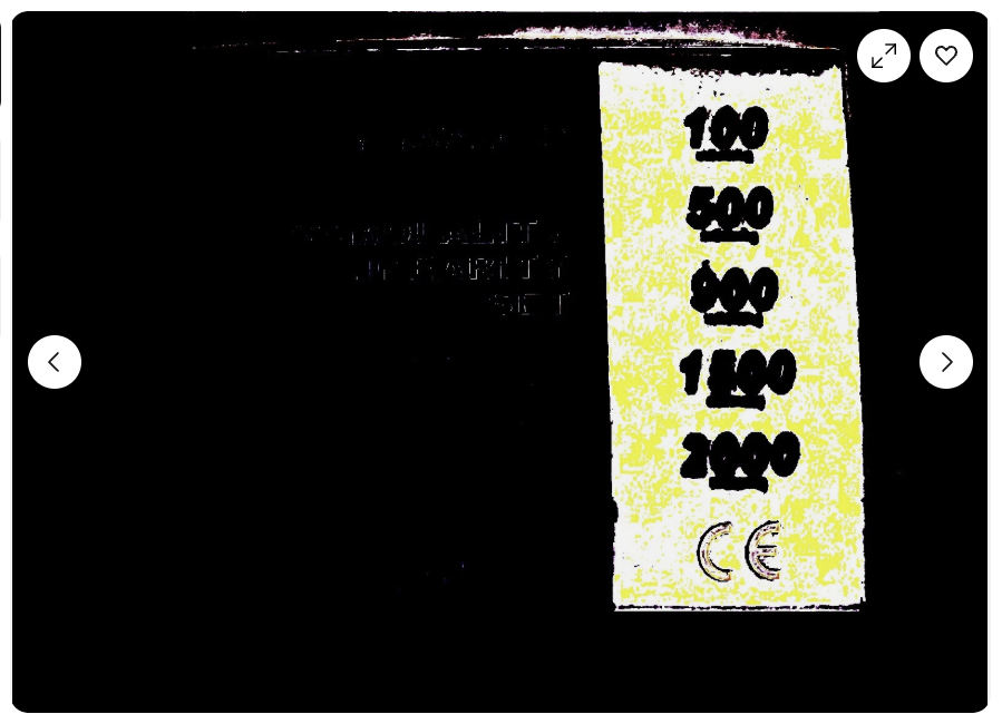

FYI, I’m getting some really corrupted uploads now. Some are good, some are almost all black. Converting from heic to jpg I think fixes it.
Can yo send us the original HEIC image? Let’s see what’s going on here.
It seems I’m not able to upload HEIC images here, only jpegs. Is there a different place I should send them to?
Just sent you an email with the photos.
Thanks for the image files.
Here is a version that should fix the issue.
However, you need to remove the image which fails to correctly upload to eBay from your listings (or listings if you are are using the very same image in several listings) first, and then re-add the original .HEIC file in order to get the issue resolved.
https://downloads.iwascoding.com/downloads/GarageSale_9.9.4b6.dmg
Let me know if this version worked for you.
Seems to be working well now, thanks.
