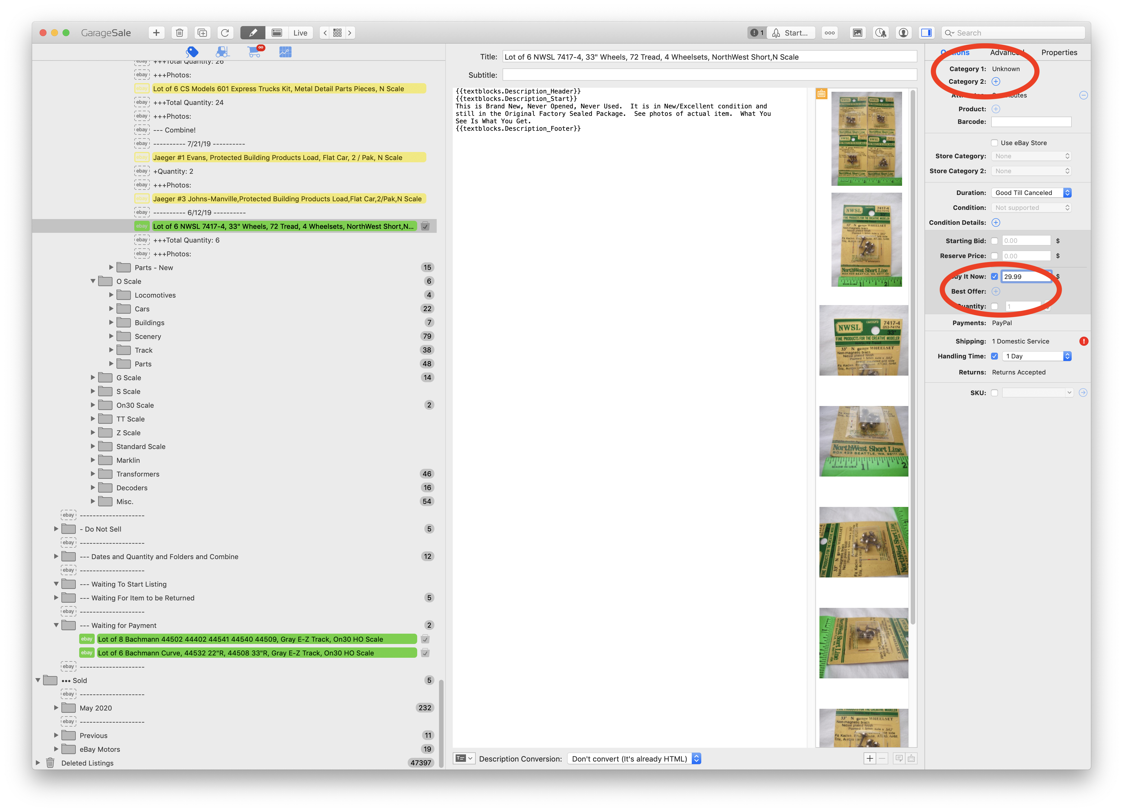

I Quit the GS app earlier today, then this evening (Sunday about 8pm) I re-launched the GS app.
A listing had Sold, so I did a Search for the title, selected the found listing, and clicked the X in the Search field to edit the listing. I do this exact same procedure 20+ times a day…
I then tried to click the "Best Offer + field, and noticed that I could not click it, then I noticed that the Category 1 was set to “Unknown”. Hence, the problem.
So, I clicked the Category 1 “Unknown” popup, and it was “blank”.

BUT… Options panel drawing not updated, as Category 1 still says “Unknown”.
AND… Bottom of Category popup window drawing not updated as it is still blank.
Select a DIFFERENT listing and re-select this listing and Category 1 shows correct Category.
I THINK the automatic updating of changed Categories is not fully working correctly…
