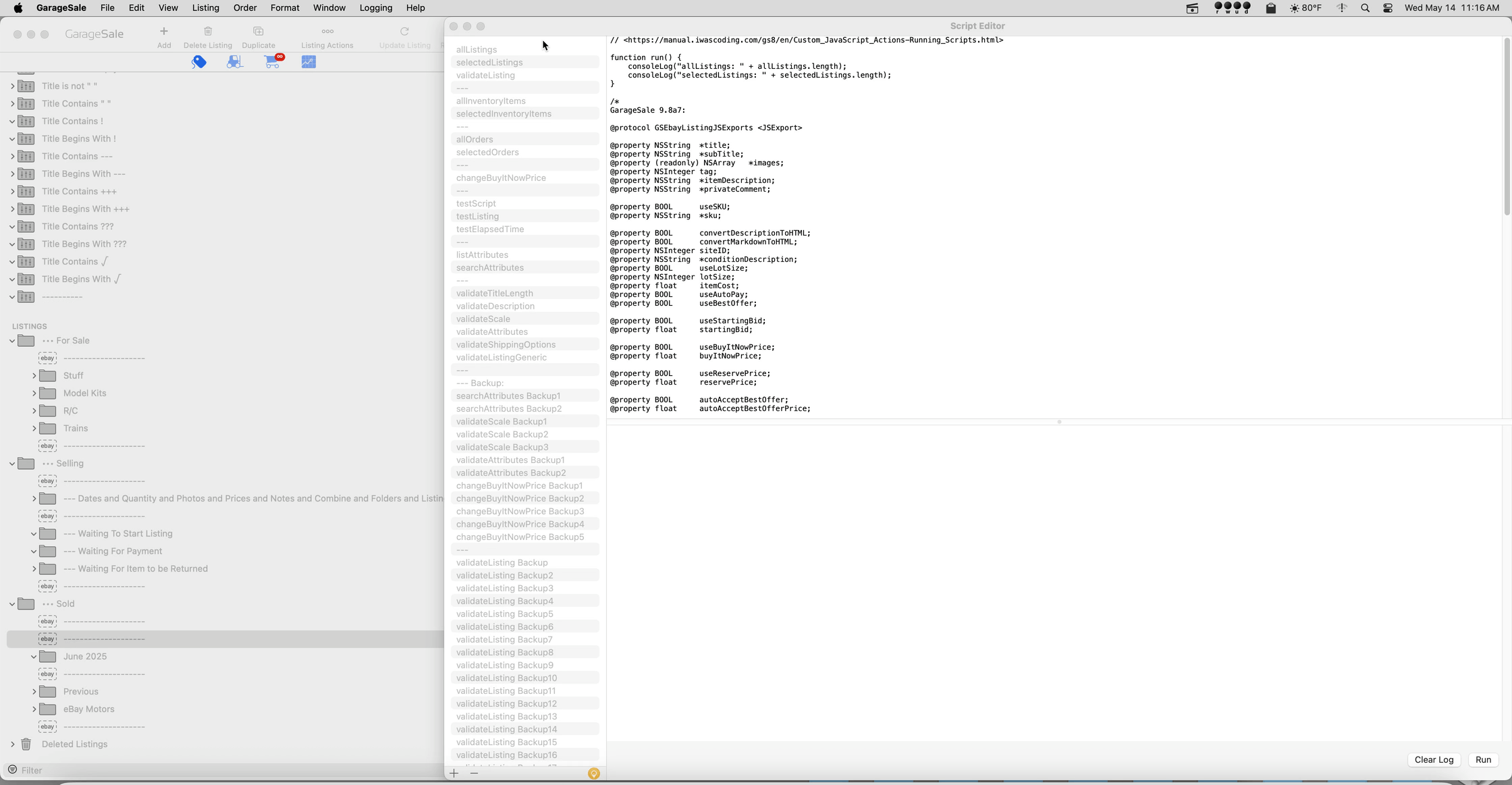

Here is a Sample and Spindump of a hang I have had a few times after pressing the Run button on the Script Editor window. Does not happen every time, but this just started happening with macOS 15.4, did not happen before upgrading.

Here are some more Sample and Spindump. This hang is happening frequently and after pressing the Run button and after the script manually runs, and after it clears the consoleLog window output and before it actually re-draws the new output from this run. Did not happen at all for months, now started with macOS 15.4.1, or possibly macOS 15.4.

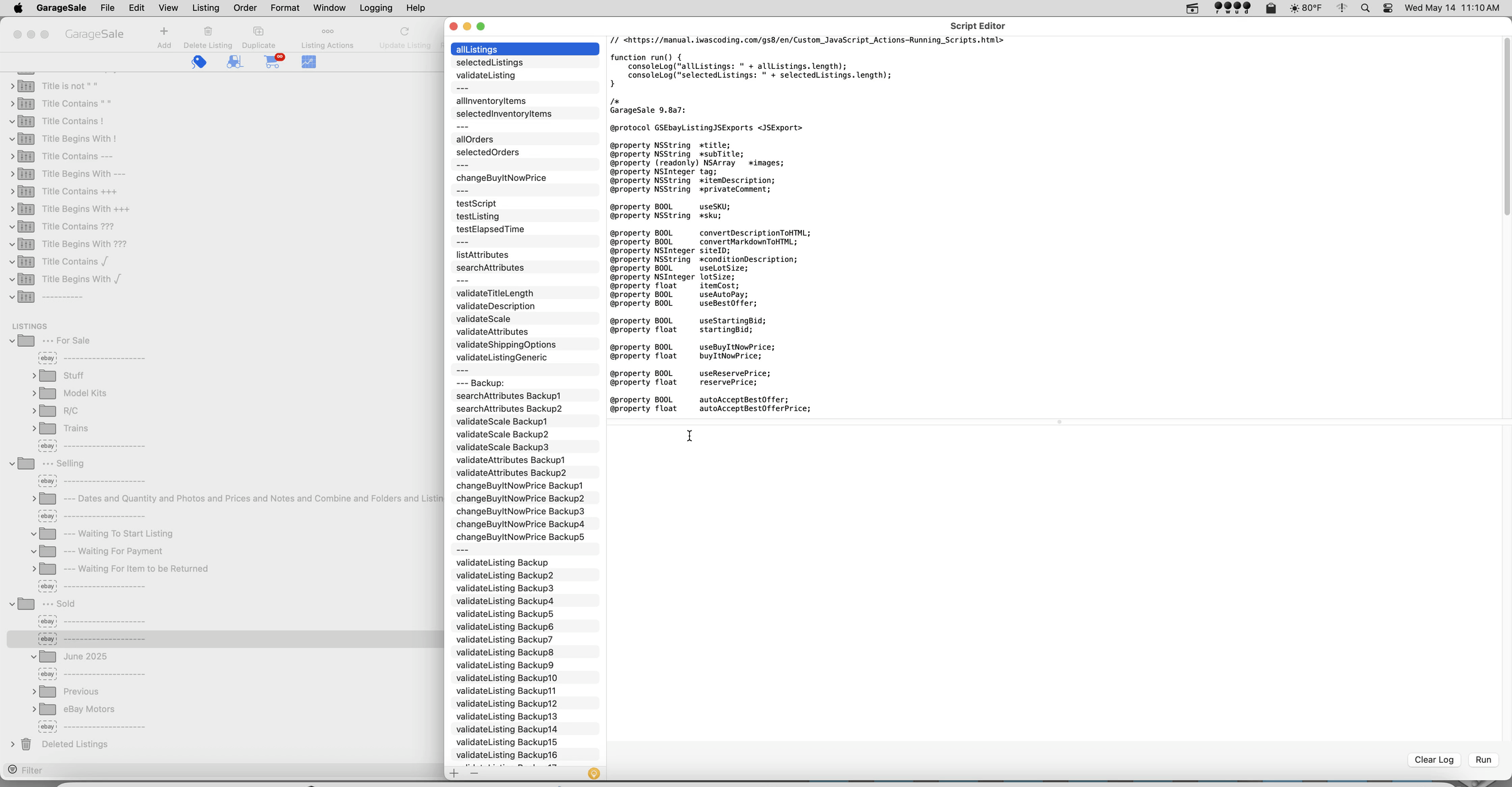

Even running this simple script 3 or 4 times in a row now causes a hang… See attached Sample and Spindump. It clears the log output from the previous runs, but never draws the new output from the current run and hangs.
function run() {
    consoleLog("allListings: " + allListings.length);
    consoleLog("selectedListings: " + selectedListings.length);
