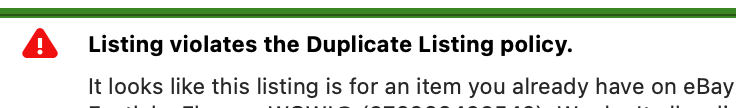

I am getting a false error return from ebay when revising. DUPLICATE LISTING?
I am getting a false error return from ebay. The error says duplicate listing when I try to just revise not start a new listing. I restarted GS and went to 9.9.2 and still get the same error

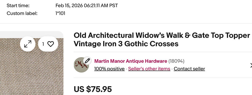

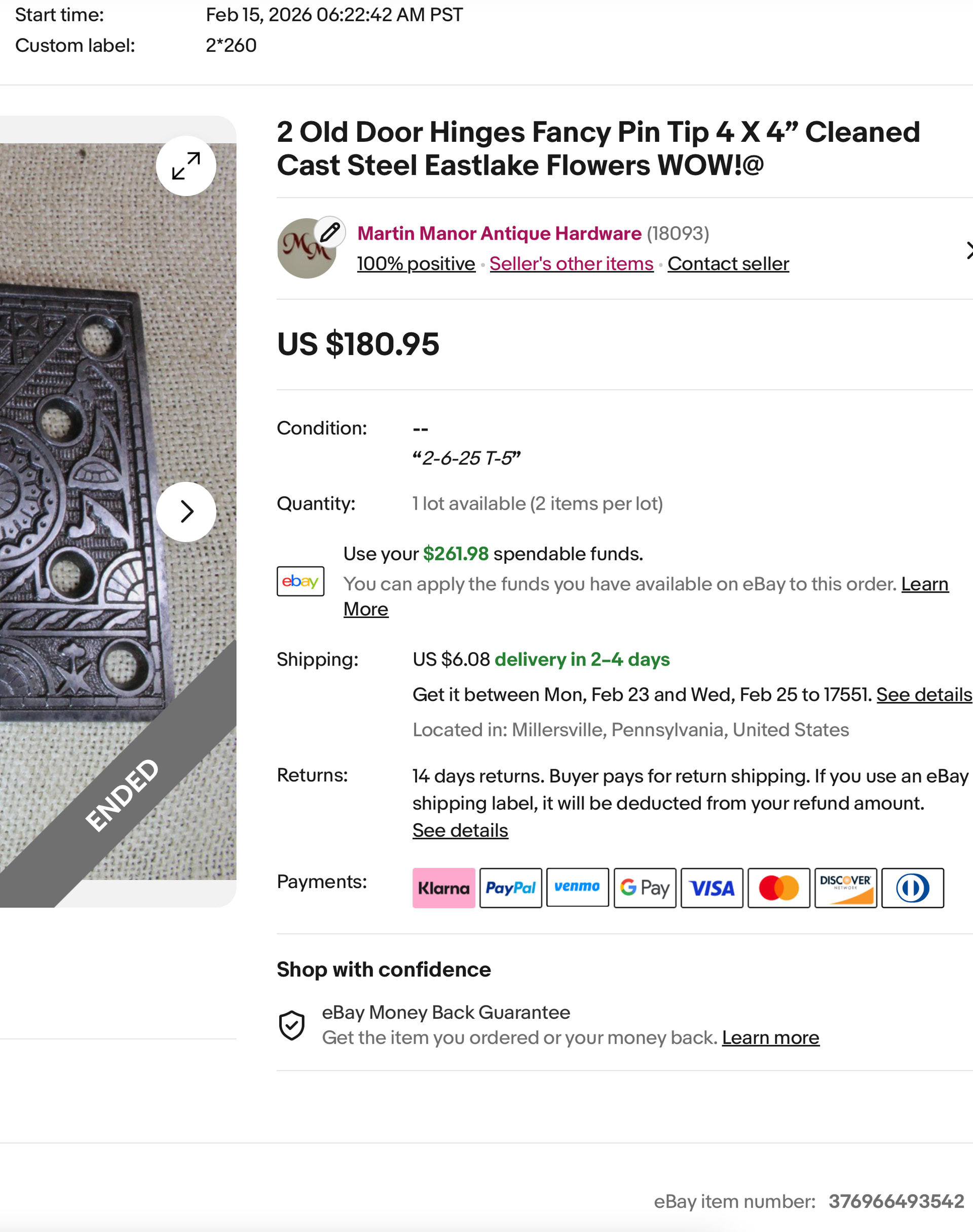

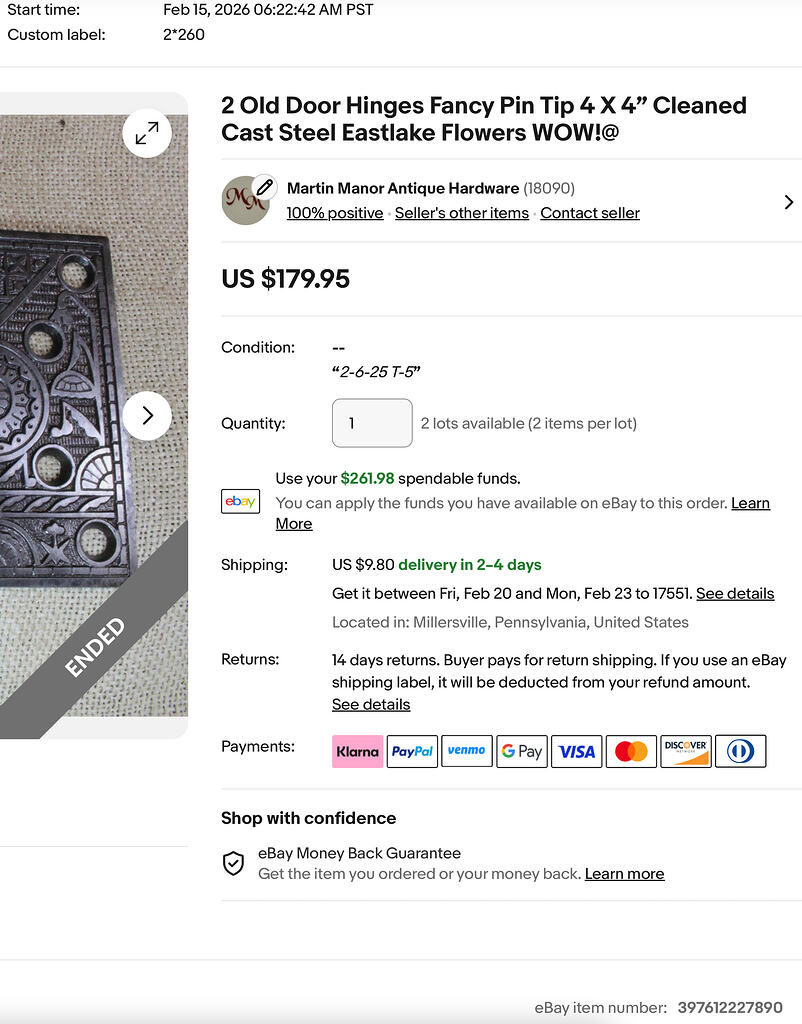

UPDATE I can report an update to this issue. GS made 2 listings at the exact same time on Feb 15, 2026 06:22:42 AM PST but they had 2 different item numbers. GS wouldn’t let me update the one because the other triggered the duplicates notice. This is a concerning development. How often is this happening?
In the 20+ years of GarageSale existence I have never heard of or experienced an issue where GarageSale starts the same listing twice by itself. In fact, I’m not even sure if that’s technically possible.
Couldn’t it be that you somehow created two copies of the listing (e.g. by duplicating it) and started both?
Another idea: Did you maybe import (one of) the listings from eBay and that’s why you have two copies of the listing in GarageSale?¿
The price, shipping cost, and quantity are different on the item because I revised it and that is when I discovered the issue. They were started by using the scheduler while my computer was resting overnight on feb 15(note the start times and completely different ebay item numbers on both). I haven’t imported from ebay for 5 years because of the integrating of the description and photos.

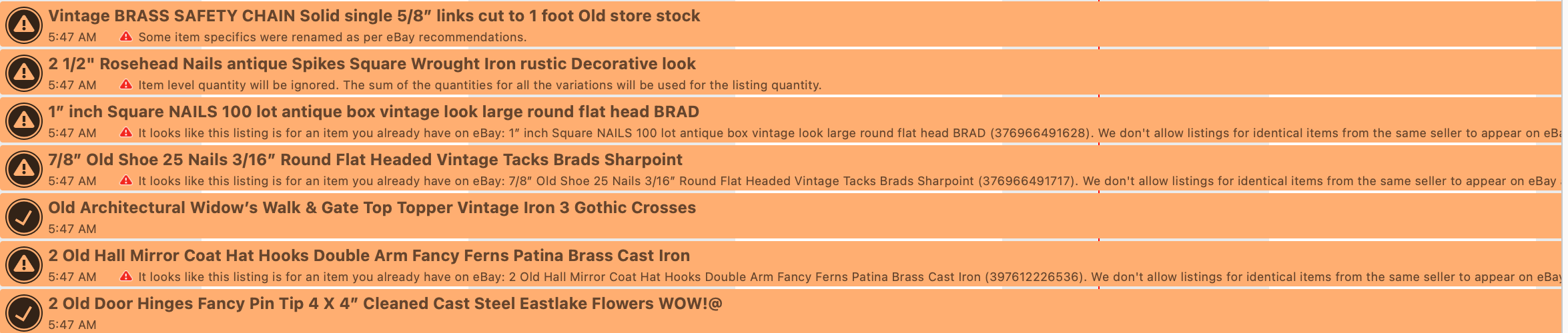

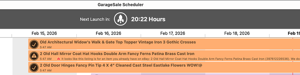

NO, GS scheduler. The last orange colored in my screen shot
GS flagged 3 other listings as duplicates before accepting the problem one. Every other day since looks fine. I was running 9.9.2 on feb 15
The others flagged as duplicate listings did NOT get duplicated on ebay

FYI I did find a second listing that was duplicated the same day…Feb 15. There are 2 different ebay item numbers for the exact same listing created 1 second apart. The listing didn’t return a duplicates flag when the scheduler started the duplicates. The last one that says “missing title” is the other listing that was created as a duplicate and now says missing I assume because I ended it.
