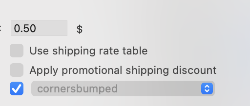

I notice that in the listings I have now, there is a checkbox labeled “Apply promotional shipping discount". Some of those are checked, others are not. I’d like to check them all.
But when I just now looked at the GarageSale AppleScript dictionary, I can’t seem to find that setting anywhere. Therefore:

If I go to eBay and tell them to apply my [full] eBay shipping discount, as described above, does the GarageSale checkbox Apply promotional shipping discount even do anything? I ask because it feels like even listings where it is not checked have a reduced shipping charge after a while.
The problem testing it all is that it may take 24 hours to modify the eBay setting completely.
Does this checkbox actually have anything to do with applying shipping discounts from eBay? Is it only about applying user-defined discounts for multiple items in one shipment?
Well to be honest I’ve started using Shipping Policies, and restarted all my listings (because of a stupid cut-and-paste mistake, they all had to have the sizes adjusted) and… now I have absolutely no idea what that checkbox does.
Is it something grandfathered in from the old eBay API, maybe?
Honestly I had no idea that checkbox existed until your support question. I use Business Polices and I’ve enabled commercial rate shipping on eBay’s preferences. No idea what that checkbox does or used to do!
The Business Polices are super easy to setup on the eBay website and integrates into GarageSale seamlessly. Agreeing with @vjl here because I also don’t know where that screenshot you provided is (mine doesn’t look like that).
