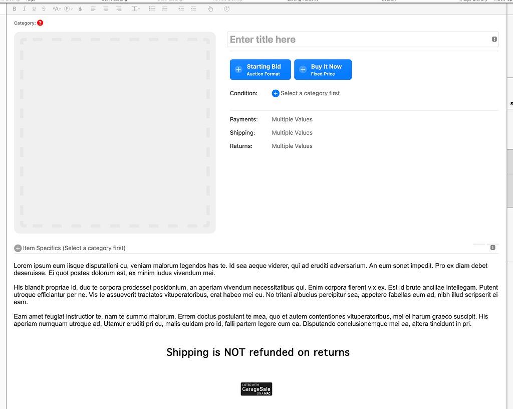

I found one of these placeholder ghosts in my listings so I went through everything and found a total of 4. No amount of deleting gets rid of them and only dragging to the trash moves them. I forget what keys to hold down to rebuild indexes or children or orphans or whatever you call them. Want to report before they run away and load up my listings with more.
Could it be that these probably are just regular listings (without title), no “ghost” listings?

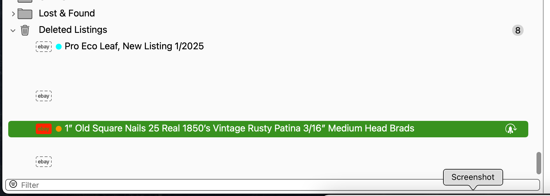

I tried to “create” a regular one without a title. I don’t get the “Lorem ipsum eum…….” stuff. I duplicated an existing listing and removed the title. But categories, shipping, pictures, ect are still there. I also got the dotted line button. So I tried to add “a new ebay listing”. I also got one with the dotted line button with a tag, and a temporary title from my master listing saved in the preferences. Here is a screen shot of my trash can with the different types of listings in there. The 4 completely blank are the ones I am asking about.
Thank you for postings the screenshot. These empty entries without a listing icon and title are definitely “ghost” items, you are right.

I ran the repair. It took 3 minutes to complete. The ghosts are in the trash yet. I assume the repair doesn’t empty those and that is normal. I’ll report back in the future if they return.
