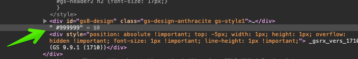

Okay, I did a search on one of your items listed on eBay and I do see the #999999 in the HTML code just after the gs8-design DIV. I’m using Safari and it’s built in “inspect element” feature. See attachment.
EDIT: it is at the very bottom of your templates after the satisfaction rating text. Maybe double check the Footer preference in GS?

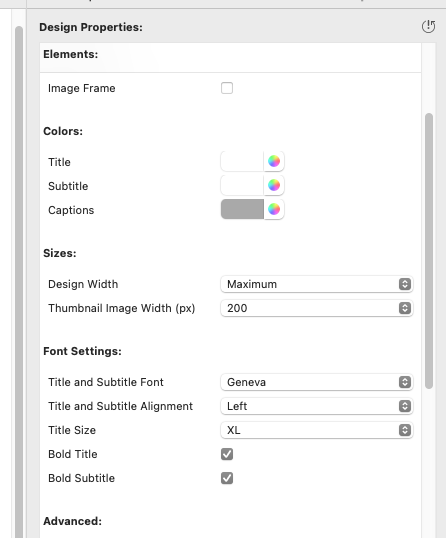

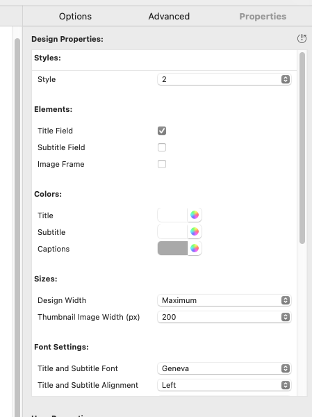

So I think it’s just the Anthracite theme, which is what I’ve been using for most of my listings. I’ve tried changing various options in “Properties” on a listing with that theme but the #999999 text still shows up.

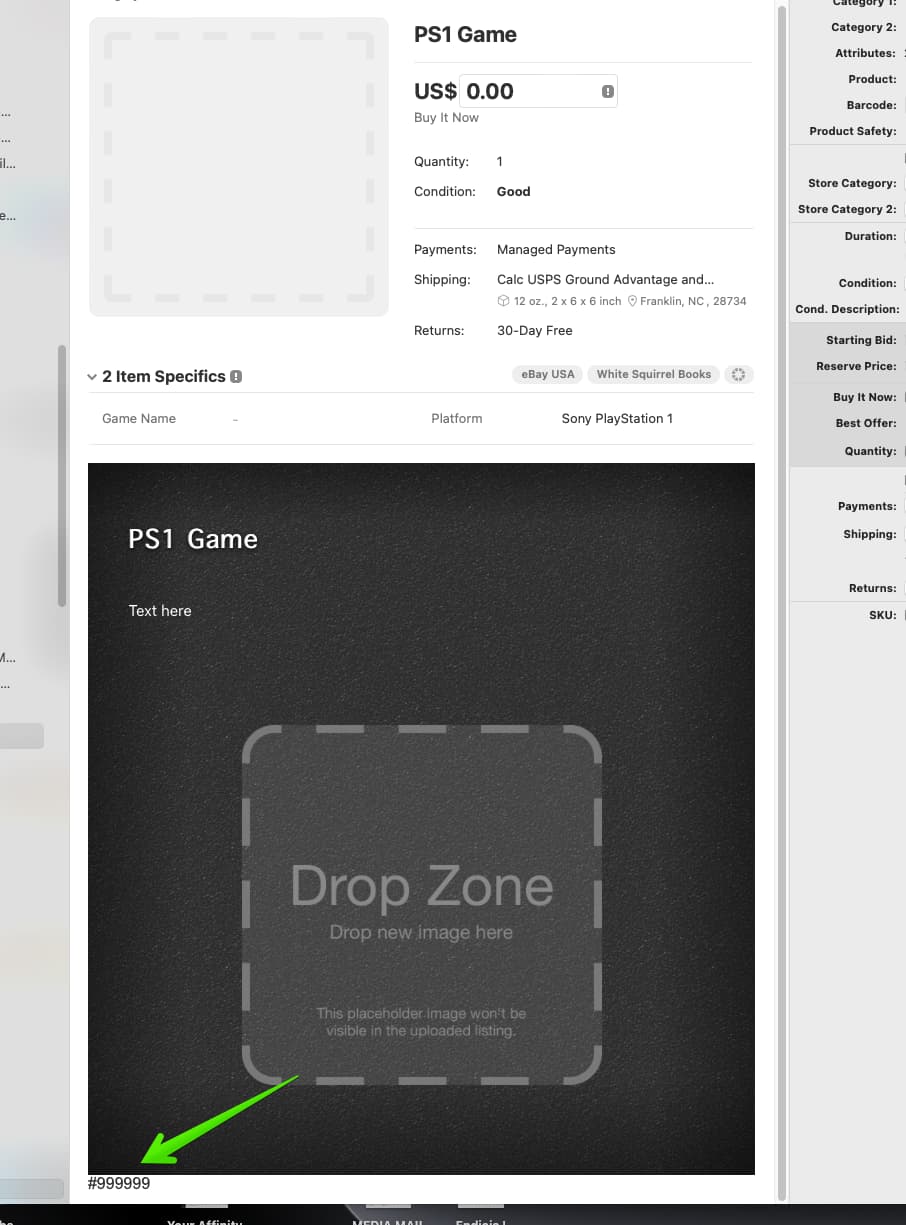

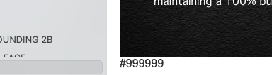

I can confirm that #99999 shows up for me without any data in the Preview area. Using default properties and haven’t put any real info other than filler text in. See screenshots.

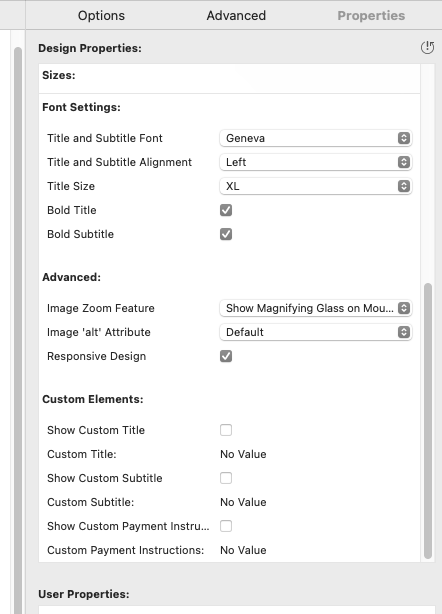

I changed different images settings - left, right, no images, hover, all show the text.

That “#999999” is the color for “Caption” that you can set in the Properties Inspector.
It turned out that the placeholder for that caption color was inserted at the very bottom of the Anthracite design by accident.
