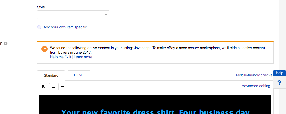

I do not at all think this is coming from GarageSale, and, frankly, ebay’s active content neutering has been invaluable here, because it looks like this code is attempted to change login fields of …something to empty values.
But I would like a sanity check from GarageSale that this, for sure, is unrelated to them. Also, if possible, any suggestions for what I should go about checking. What would have access to inject code like this into my listings? Third party apps? Some man in the middle thing between GarageSale and eBay (…that’s unlikely, but okay)? What freaks me out is
a) I uploaded a listing yesterday that I’m seeing this code inside, and the last time I explicitely used a third party app to do something explicitly was months ago
b) I wouldn’t be surprised if ebay is penalizing my listings in search rankings because of this. Hell, I only know because I checked the HTML side after seeing a warning about active content from ebay’s site.
