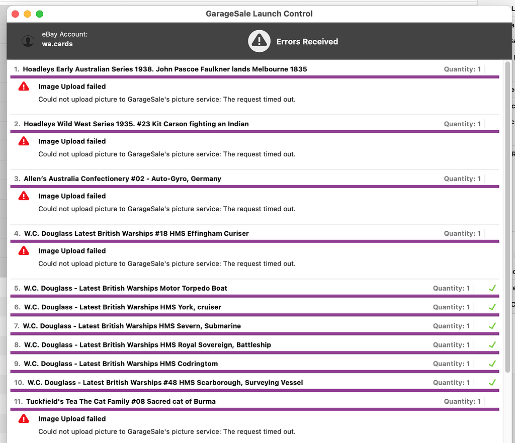

Time out uploading images

Hi GS Team
Still having enormous difficulty listing. Optus were hopeless to deal with.
Can you please tell me where this error message is being generated?

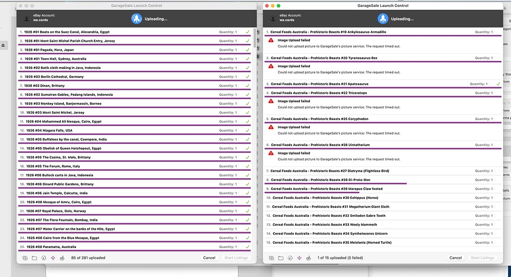

Here is something else I have just noticed. My listings are loading ok if the listing type is BIN. It is the AUC type that is failing. I have no idea where the problem lies so I have attached a spindump. I hope you can find something meaningful in it for me. Corrupt Database (again)?
The image belows shows two launch control lists running simultaneously. The one on the left are BIN listings and the one on the right are AUC listings.
Spindump.txt (3.9 MB)
PS. I just want to add that all is not perfect with BIN items as well. I just thought running BIN and AUC in parallel might help narrow down the issue.
