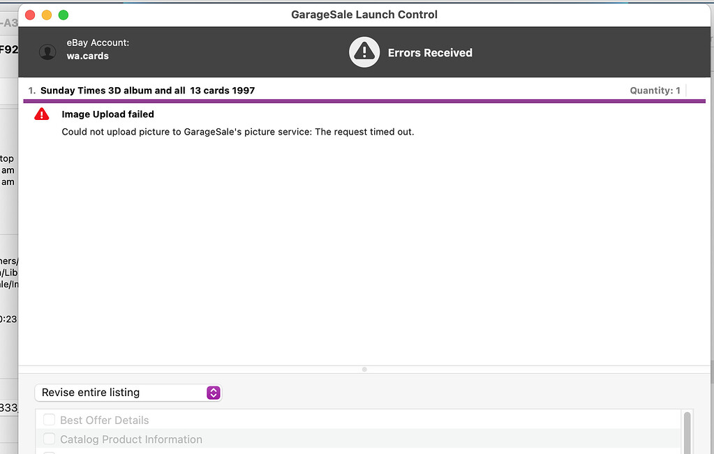

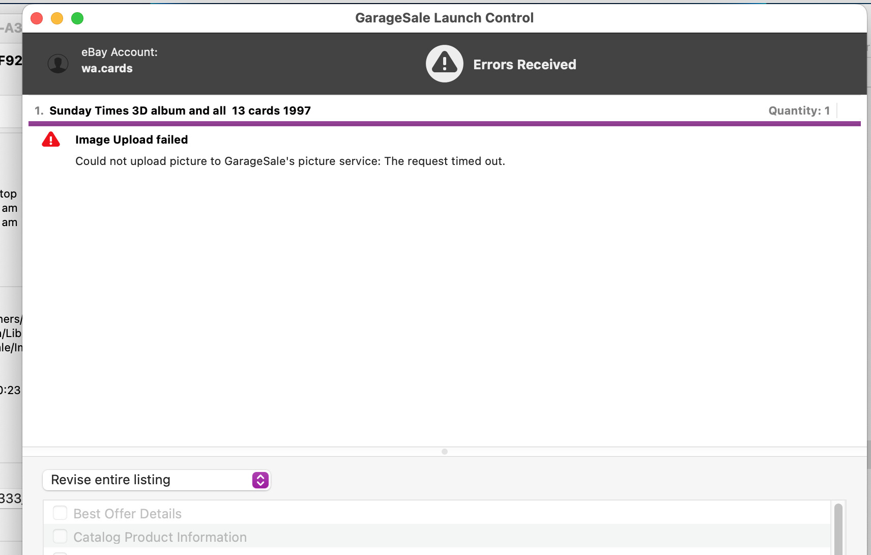

I managed to load the listing with a single image but when I try to revise it with 2 images, it fails.
This is the message I get.
I would like to know more about what is happening.

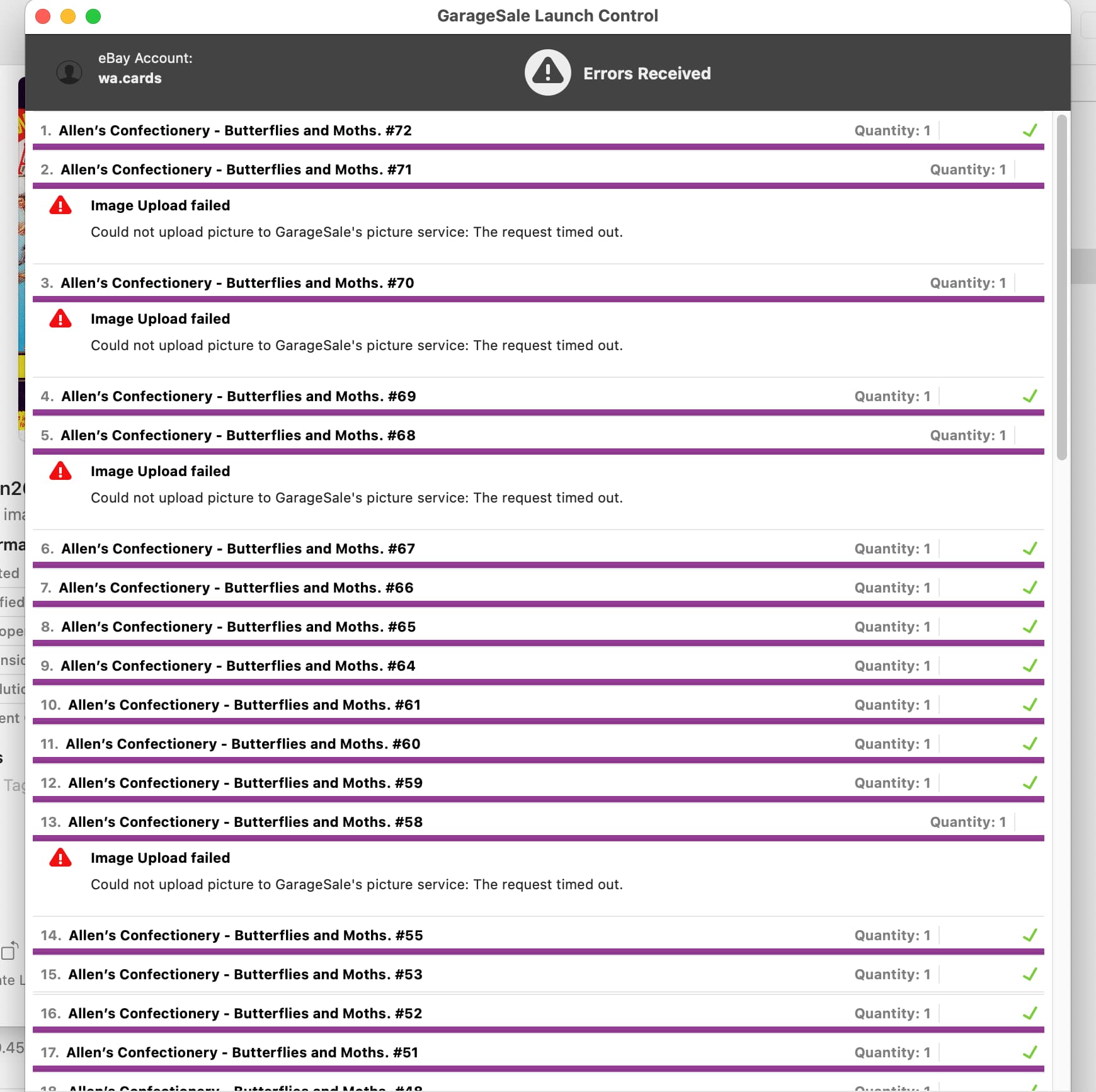

Think I have worked out the problem but I do not know how to fix it.
In the screen capture below, all the successfully uploaded listings have only ONE image. Every listing that failed has TWO images. I know it is the Christmas break but I would appreciate some help in resolving the issue.

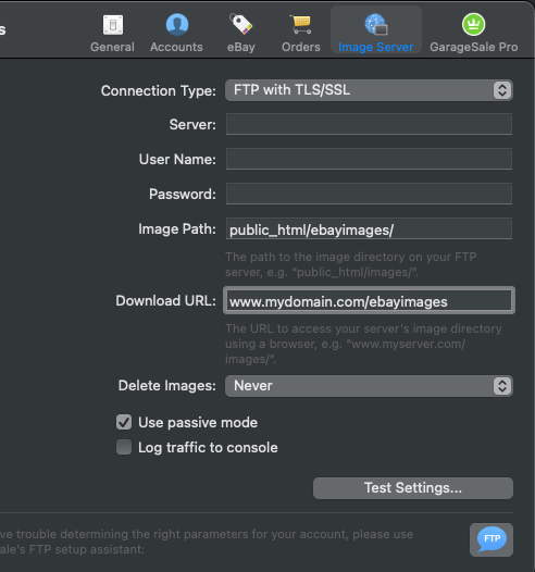

I’m not GS staff [hopefully that’s clear! :stuck_out_tongue: ] but a possible work-around to get the images up while the GS image server is having issues [or at least your connection to it is having issues] - do you have access to an FTP site? If so, you can use an FTP site to upload the images to. This would also assume you have a website where the images would be seen. I use WebDAV over HTTPS, but more common is FTP over TLS/SSL. You could make a website with a blank index.html file, just have an images folder [the site could be a subdomain like “ebayimages.mydomain.com”] and all your images from GS would live in ebayimages.mydomain.com/images/
This is basically what I do. Most hosting providers will give you FTP access to your website, and so if you don’t want to make a special domain just for it [like ebayimages], you could create a special folder on your website, like www.mydomain.com/ebayimages/ and then set GS to FTP the images to that folder. Something a bit like this example I just filled in on GS’ prefs
EDIT:" the download URL should be https://www.mydomain.com/ebayimages/ in the screenshot - my bad!

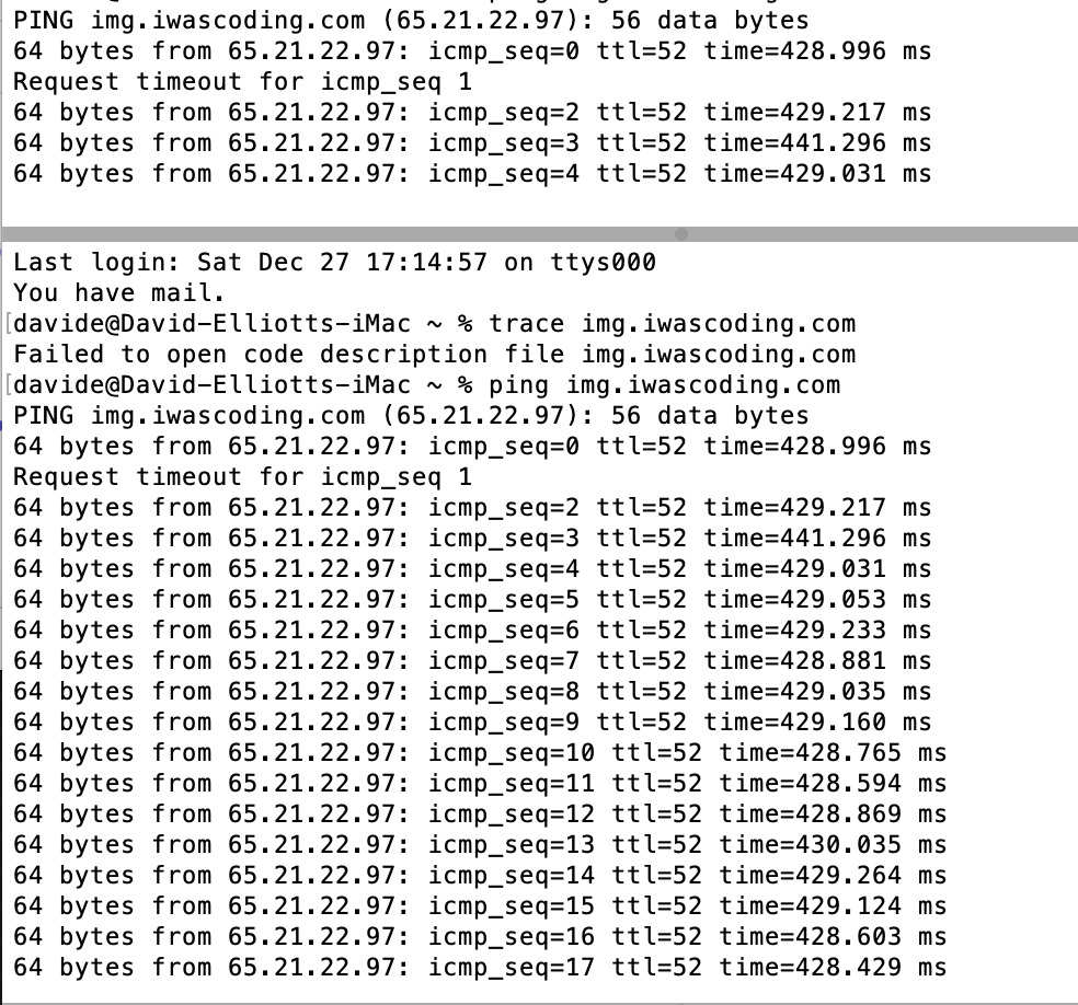

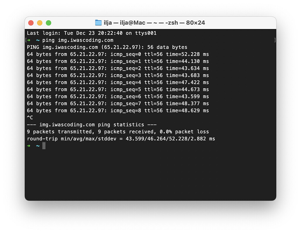

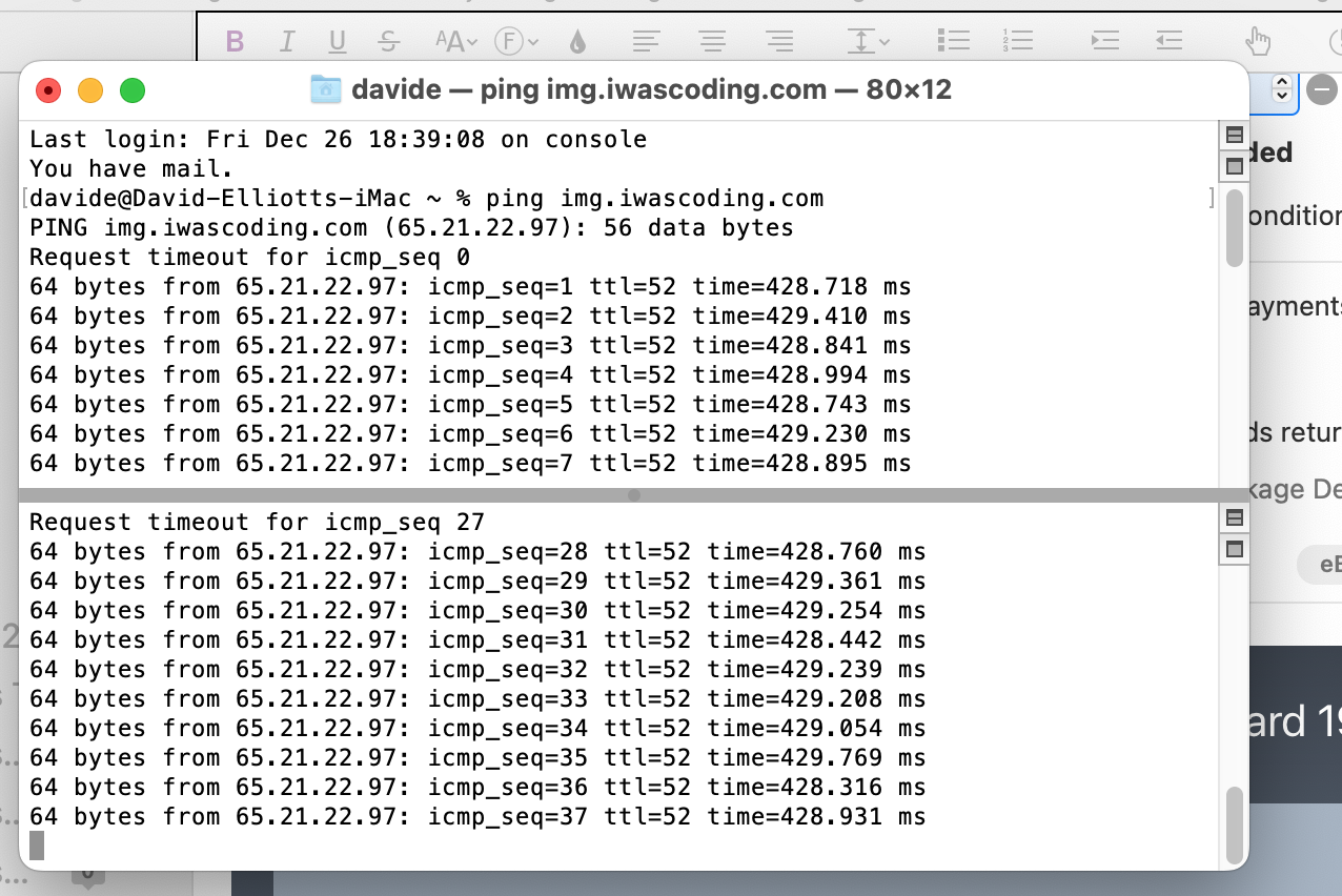

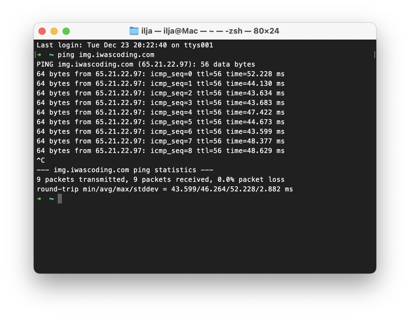

What do you get when you enter ping img.iwascoding.com into the Terminal? Looks like this for me.
Have you tried uploading listings while connected through a VPN service to the internet (NorthVPN, Privado VPN, …) . Since our servers show no issues, my guess is that your ISP may be using some kind of traffic shaping, which deprioritizes you uploads to the point that they time out, when the ISP’s network is under heavy load.

Mine looks considerably slower yet the upload speeds sum ok.

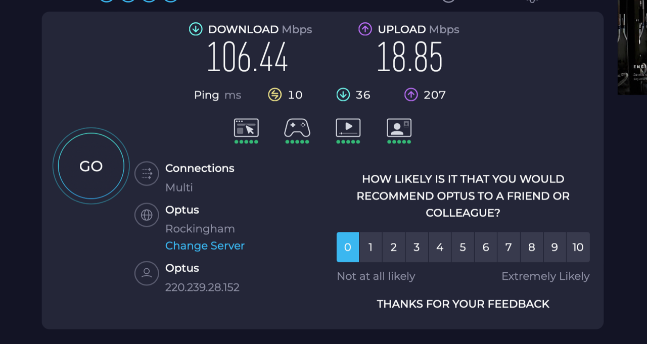

But speed tests show:
Not as much as I am paying for but should be sufficient. Maybe the blockage is ex-Australia?
Considerably slower for me. In fact 10 times slower
Contacting Optus to see off they can help
