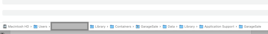

If you choose “Open Library Folder” from the GarageSale Help menu, can you please Command-Click on the “GarageSale” window title in the Finder and take a screenshot of the popup menu, so we can see what’s the path to the folder GarageSale is using?
Screen Shot 2020-11-21 at 4.32.25 PM
You need to open image in new tab to see the full image
It seems Apple indeed changed something: Instead of the application identifier ‘com.iwascoding.garagesale8’, they are now displaying “GarageSale” as directory name in the Finder.
The Terminal still shows the real name, but this is super confusing for people having multiple versions of GarageSale installed. They get multiple GarageSale folders in the Containers folder, without an easy way to determine which one belongs to which version.
