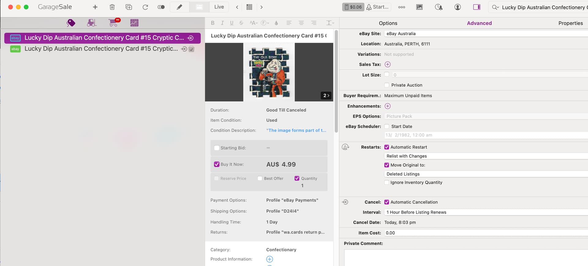

  1. Stopping but not restarting. Take this example. This snapshot was taken 1 hour and a few minutes before the GTC item was due to finish.
The same item after it had been stopped by GS.
Note now that the RESTART checkboxes are greyed out and cannot be changed. This item was not restarted. This can cause problems when selecting multiple items with multiple statuses. The restart check boxes can not be activated.
