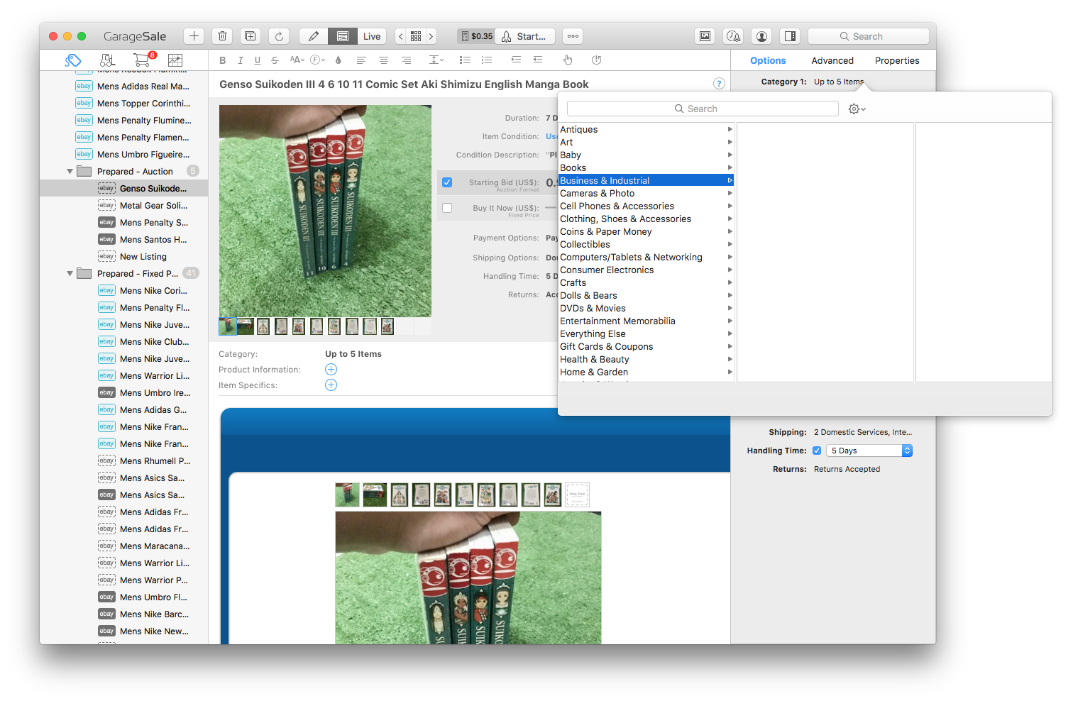

I want to load category in Collectibles for my manga listing. But GS7 didn’t load the categories, there’s no loading process or anything, it’s just plain blank like this:
*note
other categories can load just fine
Thank you very much

Does it work if you refresh your eBay token and afterwards select “update categories” from the sprocket icon in the category browser?
@jiggow if you look next to categories Search Box there’s a Settings icon that little wheel looking thing.
Click on that icon and update the categories from there, it should give you the option to do so (it gave it to me).
Also try deleting the categories directory on the garage sale folder usually located on a similar path:
hard drive name/users/user_name/library/containers(it’s a hidden folder)/com.iwascoding.garagesale7/data/library/application support/garage sale/
I was having the same problem and this resolve it.

Yes, delete everything under CategoryData two folders should be there, then reopen GS7 it will recreate them then do the update portion I mentioned.
Good luck
Were you able to update from there?
It really made issue went away, it goes to eBay and recovers the category
What version of GarageSale are you using? Also, if you keep the activity viewer window open when opening the category browser after having deleted the CategoryData directory, are there any operations stuck?

yes, but still nothing happened
@ilja im using 7.0.6 (791)
im loading the category while the window popped out
If you remove the CategoryData directory, and try GS 7.0.7 Beta 1, does the problem go away?
No idea where this new behavior is coming from, but we’ll investigate…
