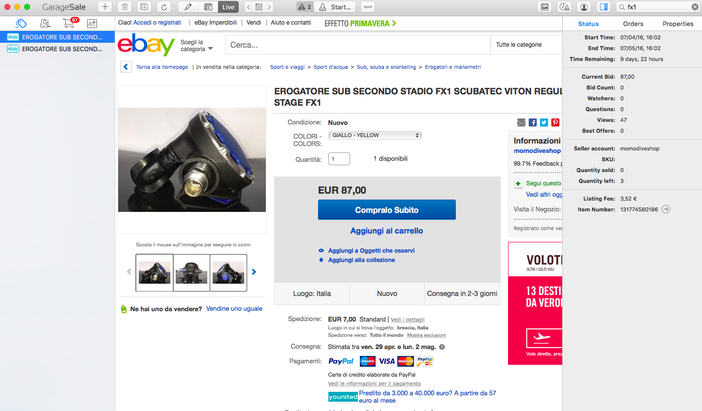

Hi Paul,
I set preferences like before. Please see image attached:
I have been tring to revise the listings but still having the same problem.

  2. Still paying image fees
    EROGATORE SUB SECONDO STADIO FX1 SCUBATEC VITON REGULATOR SECONDE STAGE FX1.gslisting.zip (11.1 KB)
Can you tell what’s wrong with my listing?

Of course you are paying image fees, if you are uploading your images to EPS. Unless you upload your image to our servers or your own server, eBay will charge you. Stop uploading images to eBay’s picture service, and you won’t get charged.

Please check and confirm if my settings are now correct. (Image attached)
I also delete My FTP account.
**Than I tried to revise listings but it’s still showing me image fees?
I also tried to removed the flag on the Variation images leaving only one image for variation but no success…
(See images
attached)**
Please let me know wht’s wrong
How about just stopping this listing and relisting it with our image server selected in the preferences?
