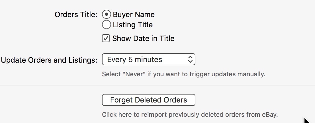

How long did you set the “Update Orders and Listings” setting in the orders preferences? And how long did you wait for the restart after the original item ended?

Set to update every 5 minutes.
